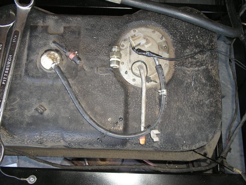

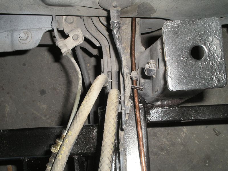

Okay I need some help. I did not do most of the dissasembly on this truck, and I also don't have any kind of manual. So I need help figuring out where the fuel lines go. There are 3 at the back of the cab, and 4 on the tank. Which one goes to which piece on the tank? Or does anyone have a stock truck with the bed off they can take a picture for me?
Heres pics:
Where do they go¿?

Don't have any pics, but can explain:
Largest line is the fuel supply line to the carb. One of the 2 smaller lines is the fuel return (bypass) line from the fuel pump to the tank and goes next to the fuel supply. The third line goes from the tank to the charcol canister (emissions). The last tank line is a vent line (red clamp in pic) that went to a location on the frame.

I got this from SSM. I'll tyry this out first, if it doesnt work I'll switch the vent lines.
