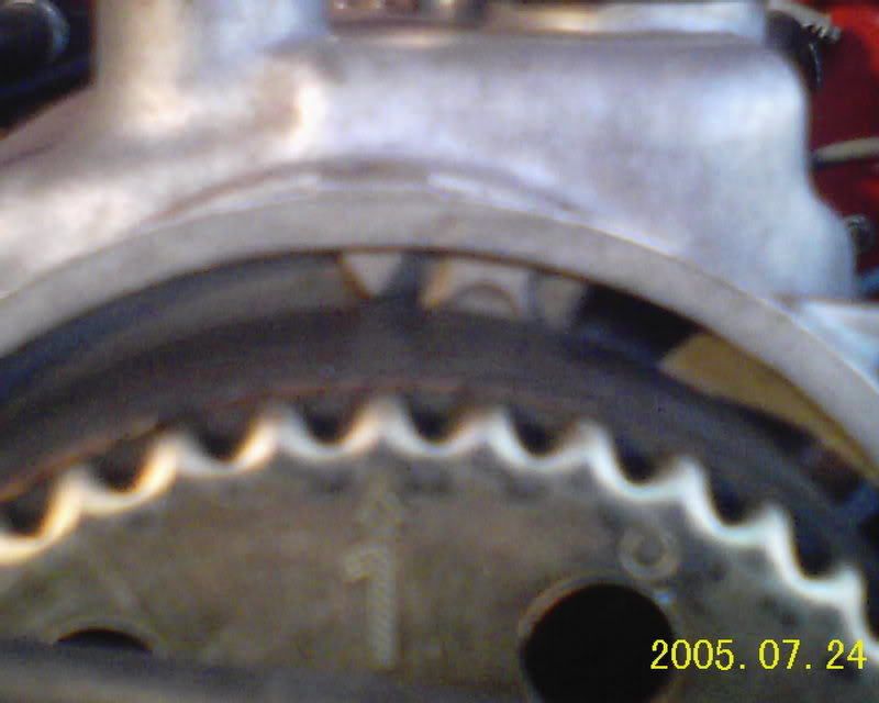

the crank pulley notch is pointing straight up and down, the notch in the sprocket is exactly in line with the pointer on the block which is at 12 oclock and here is what my cam looks like

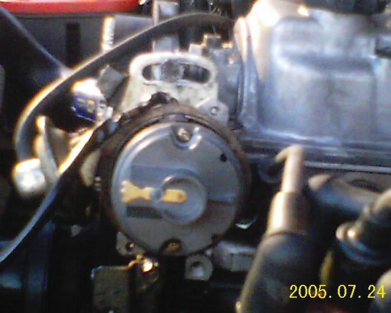

and here is what my distributor looks like
and i have a miss somewhere, the engine has all new parts cap, rotor, wires, plugs, has a weber and a header, please help me

you might be a tooth or couple off from your cam to crank? was your numero uno piston at TDC when you changed the belt? that'll help you line everything back up.
hex0rz
Yea, lol, I'm not sure but make sure that your #1 piston is on its compression stroke. If I remember right actually, I think you need to set the 1 mark a tooth to the left and make sure the belt is tight. Take out the dist. and realign your rotor so you can double check that it is firing on #1... Other then that, its hard to say!
