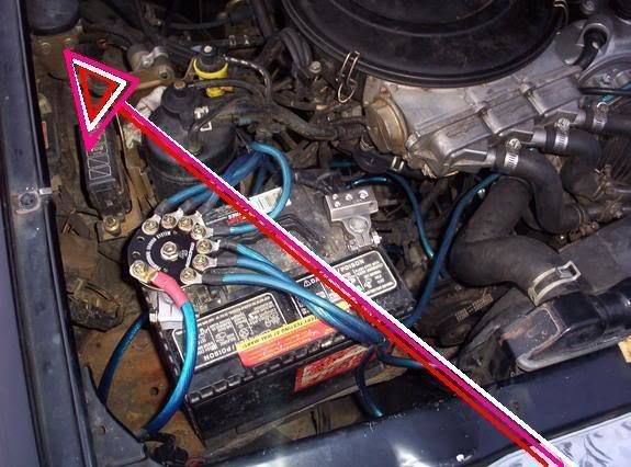

hex0rz
Check out my weber carb techie. The throttle response is definitely very sensitive. If you are not out in the freezing cold like I was, it should only take a couple hours to install the carb. 3 at the most when you include removing stock stuff and your tuning.

There was this little piece that kind of had the shape of a fuel pump that was inside of my passenger fender and it said "arrow" or something like that on the top of it. it has 3 outputs, and smells like gas. i took it off. whats it supposed to do? should it be on?

The black canister on ur passenger side fenderwell is a charcoal canister that took fumes from the tank filtered them thru charcoal and circulated them into ur carb to be burned.If not too late u probably need to leave this intact or u run the risk of having fuel smell in ur truck.If that doesnt bother u then take it out.BJ
hex0rz
Actually that piece your pointing to in MY picture, LOL, is the high alt. sensor! It is apart of emissions, so you can rip that out too. The big black canister next to the battery is the charcoal canister.
I've been told that when you rip out the computer, everything will be fine, except your windshield wipers. Those are ran through the comp. So you will have to re-hardwire it to your fuse block.
