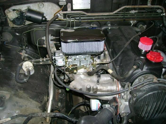

this is a pic from 88b2200mazdog's
is it coming out from where the breather filter is?

yep. exactly where the breather is on your valve cover. and SOUTHERNRAZED it is building pressure. i put my finger over it for a few seconds and i could here it when i took it off. i did hone it out but didnt check my walls and talked to my dad about it today and he said i was supposed to use oversized rings. i dont know. BUT i drove it today while it wasnt so hot and not as far of a drive and didnt have the problem
