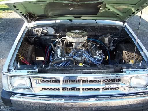

check out baggedb22, he has a 302 in his, & a 9" ford rear end....he could help you with info on the swap.....

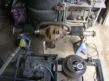

i've got a 302 with a tremec tko tranny, and a narrowed ford 9" rearend. in my 90. i got plenty of pictures i can email you too. i've also got a set of brand new motor mounts for sale for a 302.

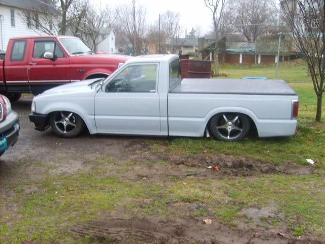

NYTRDR24 was close but not exactly right, i have an 351 winsor, c6 tranny, and a 98 mustang 8.8 with disc brakes and an lsd in mine. the swaps pretty much self explanitory, i did run larger fuel line, but other than that im running the stock fuel tank, if u run fords electronic distributor with there duraspark ignition getting spark to the motor is as easy as one wire, what tranny are u going to run?? i had to move my motor mounts forward alitle built and the tranny mount back alittle bit on both i built off the stock motor and tranny mounts, if your not into cutting the tranny tunnel depending on what tranny u run u will have to dent it with a hammer to clear the bell housing

Hey who narrowed your rearend...I wanna narrow My 8.8 for some 22x10's in the back....
