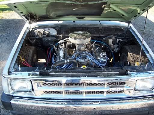

Heres a pick of my motor so u can get an idea...
beating the tranny tunnel you will only have to do that on the front part of the tranny tunnel where the bell housing will be. You could cut an reweld it higher i just wanted to get mine in and running=) My hole motor is out a truck it had the truck motor mounts and the truck rear spump oil pan. My motor is about 1/2" off the ground when laided out and im still not under a stock hood. lol... like b5000 said i have about a 1/2" between my motor and rad, im running a aluminum nissan 240sx rad and 2 electric fans behind the grill. I built my tranny mount right off the stock mazda tranny mount just had to move it back alittle. You'll be very happy with the end results
