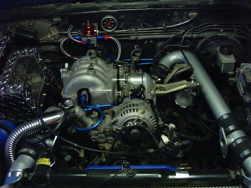

If your wanting to put the rotary from the rx7 into the pickup its got to be about as much work as swaping a v6 or v8. What year of rx7 is it?

hahah im doing that swap right now...forget using anything but full custom or " highly moddified engine mounts and if you think that is your biggest concern think again..but u are right having the whole car will make life easier right now i still have the body off the frame with rx-7 rear susp. in and bagged..as well as engine mounts and new tranny crosmember in....i do have some wireing concerns but ill get to that road when the day comes my harne came complete and the only wired that are cut are the wires from the engine loom to the guages/ignition ..plan on having engine truck on the road by the end of july

By the way I've already done the swap also and it's a 87 Rx-7 Turbo II, just trying to finish the metal work right now.

I made my own motor and trans. mounts, and had a local truck shop rework my drive line. Also you need to shift the shifter hole back depending on how far back in the bay you plant the motor. All the electrical and instrument gauges from the rx are in it as well.
