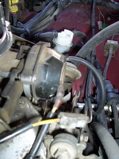

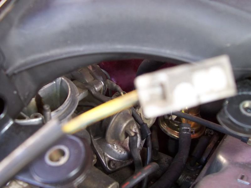

I can't find where this plugs into it runs out of the back of the carb anyone know? its a yellow wire with a blue stripe.

do you have AC? I dont recognize the plug right off but could be an AC dashpot to speed the idle up when the AC kicks on.

yeah i have AC where would that plug into if it was what you said?

theres something to that which plugs into the intake/carburator

That's the electric choke wire that plugs into the back of the alternator.

ive already been told that and it wont reach to the alternator and there isnt a plug on the back of it.

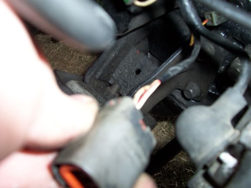

robbie
just checked again and there is something already plugged into the back of the alt.

you can see the choke clearly in the picture and it already has a wire on it.

Here is a pic of a stock carb.
That's the only wire that is yellow with blue or green stripe with that kind of plug.
robbie
that is the wire I'm talking about.
