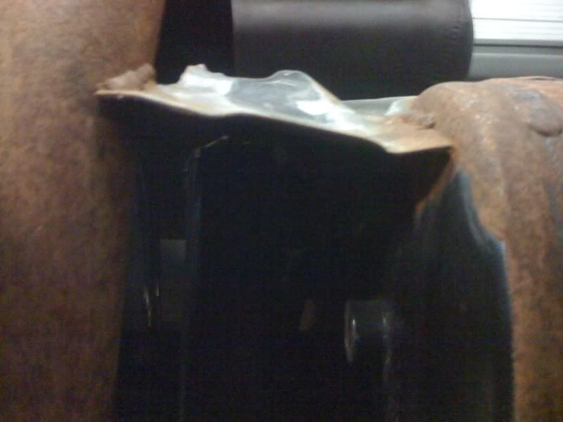

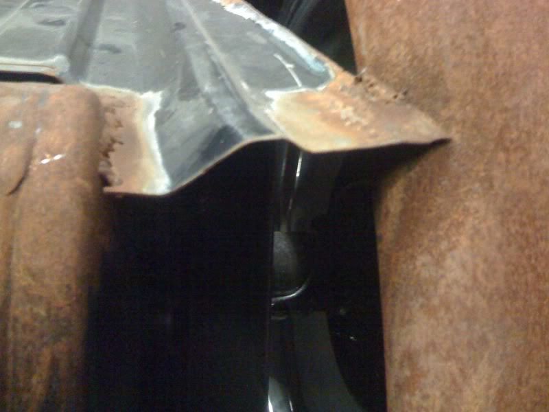

Well I figured if I waited I would forget so here are some pics.
