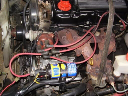

[quote="1HotDawg"][quote="bagman"]what i did was crank it up and start pulling vac hoses and plugging them...if you pull one and it dies,then put it back,and for the exaust stuff...take your heat shield off(youll have to cut and resplice the o2 sensor wire)get you 4 1/4 pipe plugs and put them in place of the 4 pipes on the manifold,and for the other two...cut them as close to where they hook up down low,pinch them with some vice grips
Dude that rocker cover looks great, and the WD can being the same diameter as the coil is deff considerable as unique, I once used a ronson butane can as a quick patch on a radiator neck, along with some JB Weld of course. I was about half way through a 400 mile ride, and of course I had my tools with me. it held up beyond the rad. which was going fast. It ultimatelty failed , but not on count of repairs. I now have a dual core aluminum radiator. and it's good now. Nice Improvision.
