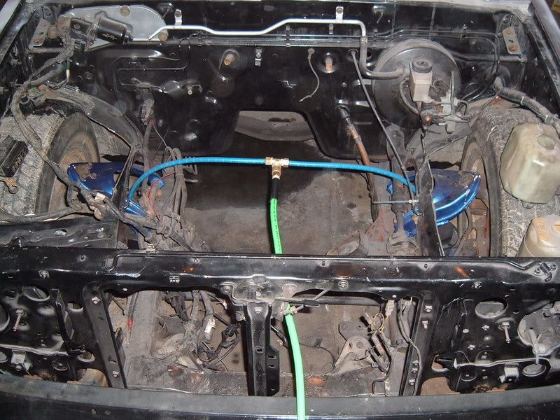

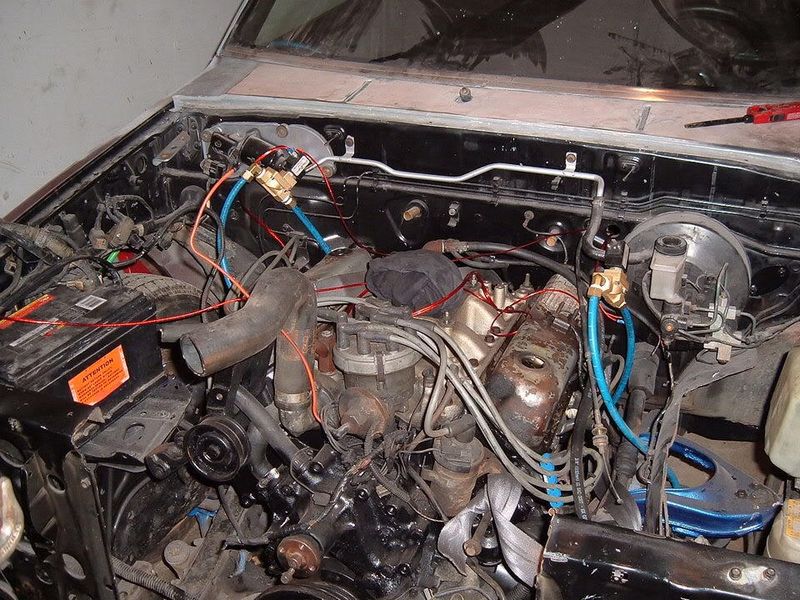

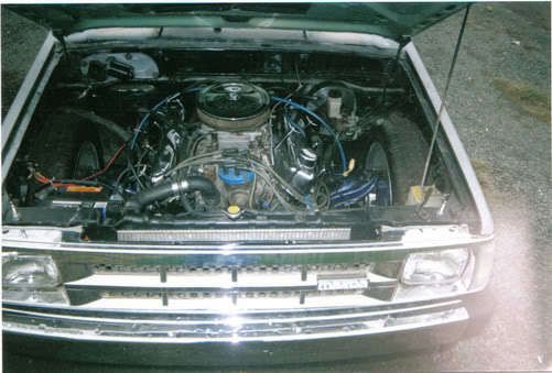

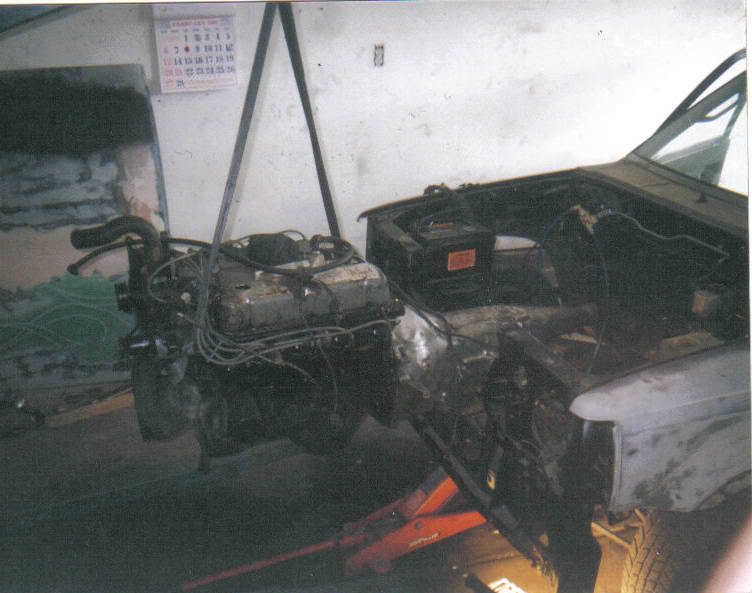

Heres a few pics from installin it and getting everything together, and one from this fall, Alot has changed though..
