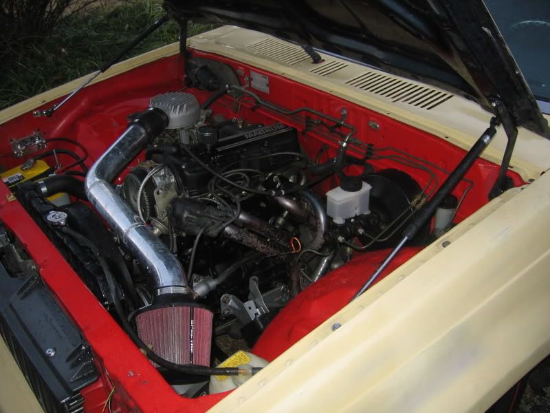

Hey guys he hasn't been on here in awhile. I've got the same pieces he's talking about. I ordered mine off of eBay but you can find it on several websites. You can use a cheap Honda intake kit and filter or do like I did and build your own . I took some tubing and had someone weld it up for me and I added a filter on the end. Here's a pic

umm, yeah, what he said there. Personally though on a carb I don't see much of an advantage running a cold air setup like that. It seems that it might even be a bit too restrictive. My guess for what might be the best for a weber carb would be a similar steup to a shaker hood assembly over the carb with a wide open element filter.
