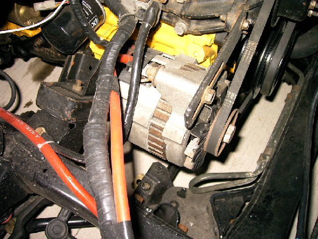

mazdizzle
I'm running a 180 amp GM cs130. It almost bolted right in.
drpdmazda
how hard was it to wire it up to work on the mazda?
mazdizzle
Wiring wasn't bad at all once I found the wiring diagram for it. The plug in the back of the alt has 4 wires on it. The thick red one went to the charging post on the back of the alt, one went to the electric choke and the other went to the switched wire that tells the alt to I guess come on when the key is on and the 4th isn't used. I picked this 180 amp alt up on ebay for around $45.00 shipped. If you need to know exact colors or for more pics juet let me know.

mazdizzle
I'm not sure what mine came off of. The next time I'm at the junkyard I will see if I can figure it out for you. It had a serpentine belt pulley on it when I got it if that narrows it down any. On ebay it was just listed as a 180 amp 1 wire GM alt.
