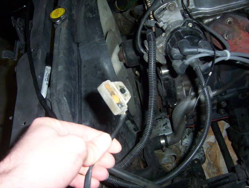

i was wondering what the hell thi is i have no clue

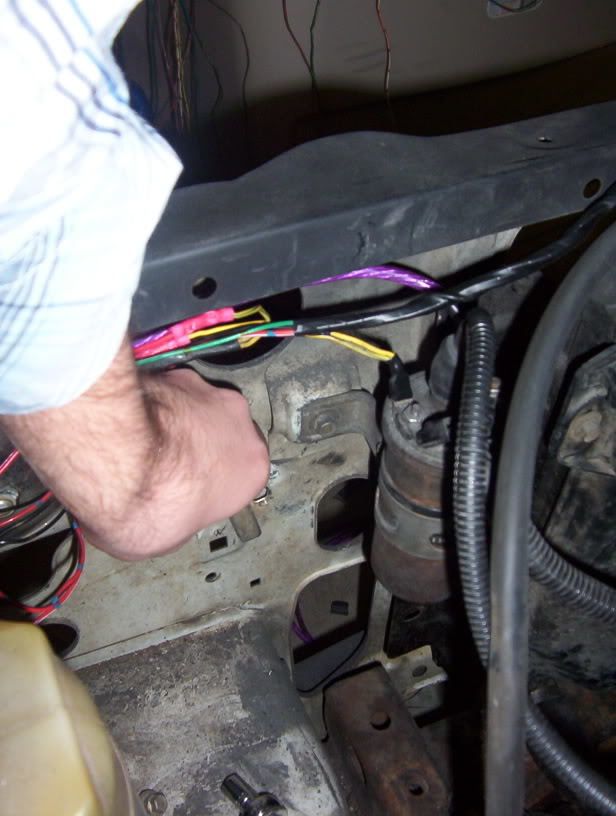

it comes off the coil and its bolted on the front of the core support

I THINK IT IS THE RADIO INTERFERENCE CAPACITOR...

i think its aftermarket i dident have one when i ripped everything out

come on what it be i really dont know but deffinately not the snar flap jk, but naw i was just wondering if i could get rid of it but it runs right off the coil in the same pace where i ran the wire for my tach

LIKE I SAID I'M PRETTY SURE ITS THE RADIO INTERFERENCE CAPACITOR, THE ONLY WAY I KNOW TO SEE IF IT IS, IS LEAVE IT OFF, CRANK THE TRUCK TURN THE RADIO ON, AND IF YOU HEAR THE MOTOR "WHINE" THROUGH THE STEREO THEN HOOK IT BACK UP. MINE HAS THE SAME THING ON IT, IF IT WERE RUNNING I WOULD LET YOU KNOW. I'LL LOOK IN MY CHILTONS WHEN I GET HOME AND SEE IF I CAN MAKE HEADS OR TAILS FOR SURE, AND LET YOU KNOW TOMORROW AFTERNOON.

I LOOKED IN THE BOOK, THE WIRE RUNNING TO THE RADIO INTERFERENCE CAP., FROM THE COIL & DIZZY HAS TWO YELLOW WIRES, I LOOKED AT THE ONE ON MY TRUCK, THERE WAS A SOLID YELLOW, AND A YELLOW/GREEN STRIPE WIRE, THE CONNECTOR WAS THE OF THE SAME TYPE THAT IT SHOWED IN THE BOOK, SO I'M ABOUT 99% SURE THAT IS WHAT IT IS...
HOPE THIS HELPS!
