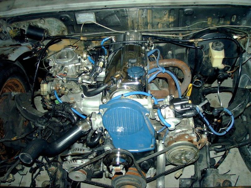

sorry its so dirty in there.. but ugly pics are better than no pics.. let me know if u need anything more specific.

ok bro here is what my engine looks like now, i am working on it now..no emissions on it..with stock carb..

how did u get that stock carb to work w/out ALLL those vacume lines?

hey man, i plugged the shit out of it, and also bypassed some crap in it. it runs okay i guess. we will see when i start her back up, i havent started in about year and a half..sucks
