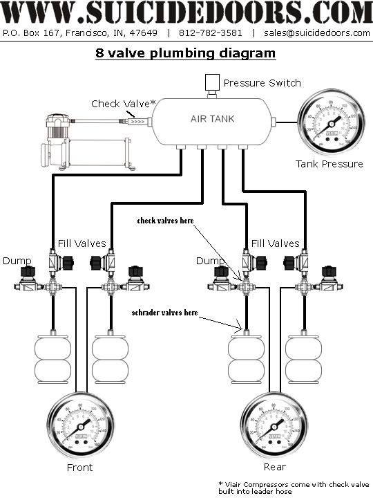

what do you mean after, like bag dump then check and do I half to run 4 check valves i plan on running front and back so could I use just two.
maztang (ryan)'s avatar
maztang (ryan)
i added to the suicidedoors.com pic but here you go. it is best to mount the valves on the bags aso that you don't lose a lot of air when runnung compressors, also lessens the possibilities of leaks. you want the check valve mounted to a t on the bag, then the dump valve then the check valve then the fill valve. hope this helps.
S(
solow93 (ryan)
yes it does thanks
