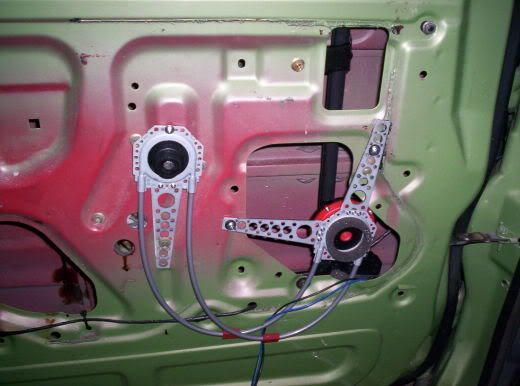

its fairly easy and well worth it! i did mine using the Spal deluxe kit and it was a breeze. definitely beats the hell out of having to lean over to roll windows up or down. the only tricky part is if your not familiar with wiring up relays for reverse polarity OR you can use dpdt switches
heres mine installed.

alright i guess im going to have to try it but do you think a rodeos setup would work?

rodeo set up should be a direct bolt in pretty much. just make sure the donor vehicle has the same doors as your truck. in other words with or without vent windows.
