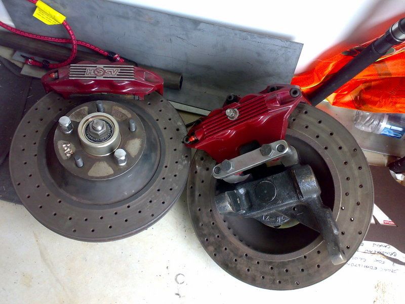

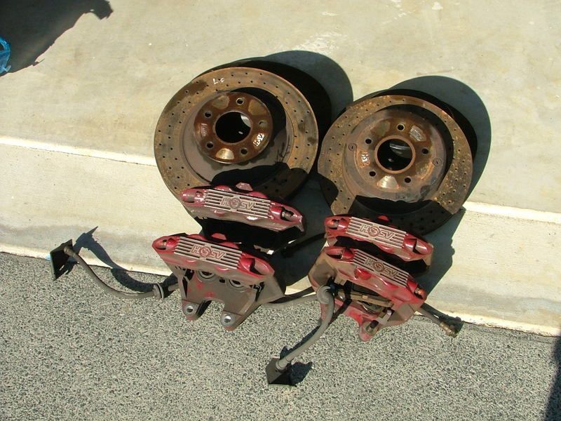

Got my brakes sorted. Thought I would share some picks with you all.
When I got them.
Now fitted to my drop spindels
