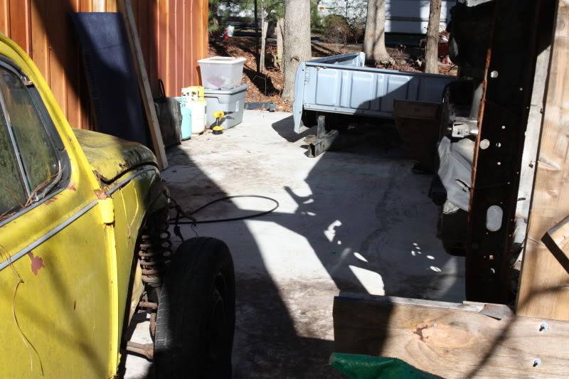

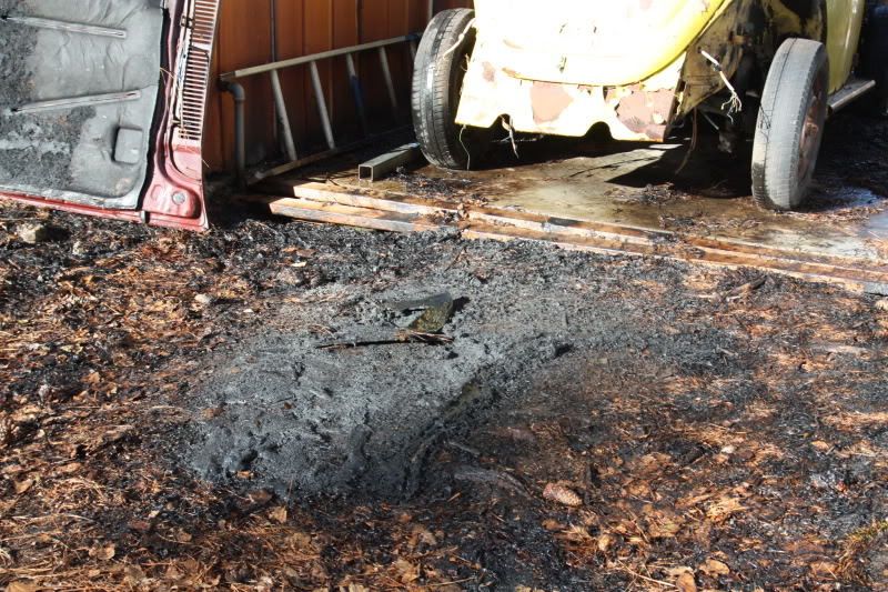

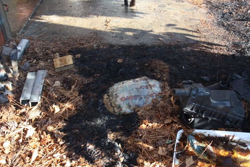

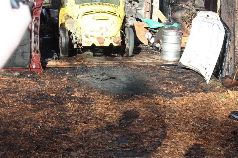

Welding and cutting outside on a concrete pad. Fall leaves were piled around the area of work. After finishing temporarily, we went inside shortly after. In the span of about 30 minutes an unseen ember from welding or cutting or grinding metal caught dried leaves on fire.

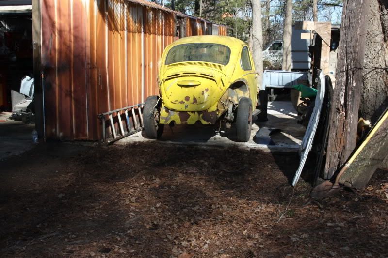

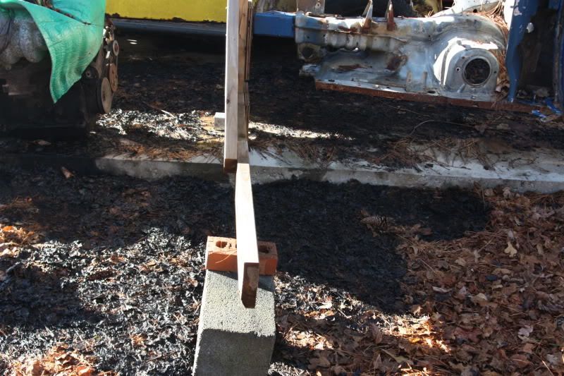

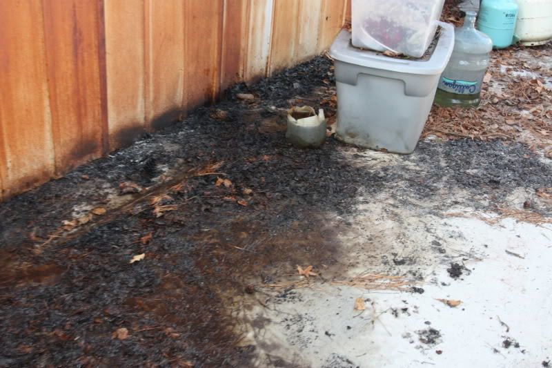

This is the general area we were welding. Notice the piled up leaves against the side of the building. Also take note in the top of the photo are containers of propane and refrigerants that were IN the fire, moved out as flames were licking at one of the containers.

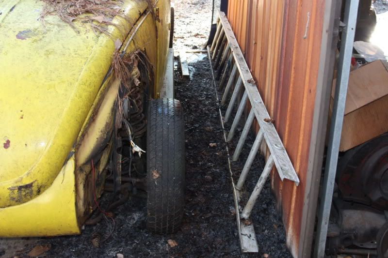

The fire burned along the side of the building. Just on the other side of the thin 16ga panels is about 50 gallons of various VERY low flashpoint fuels. Literally only 3 inches away from the fire. In open-vented containers.

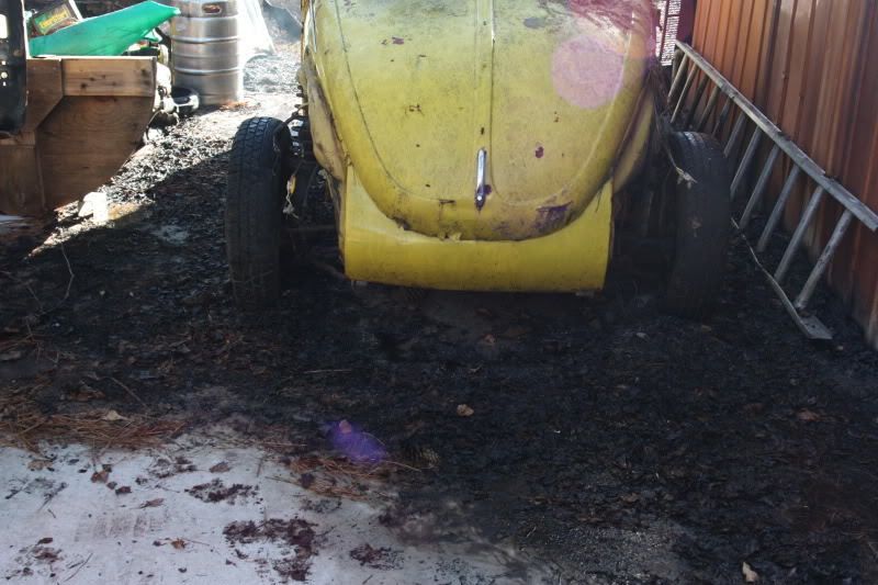

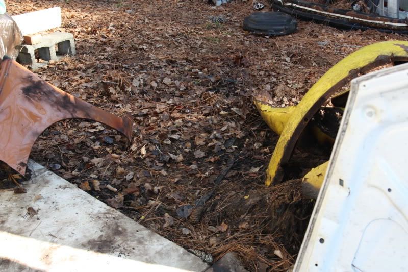

Burned under and around a vehicle. I later noticed the carpet was smouldering. Also the tires were steaming and a previously FLAT tire was aired up from the heat expansion.

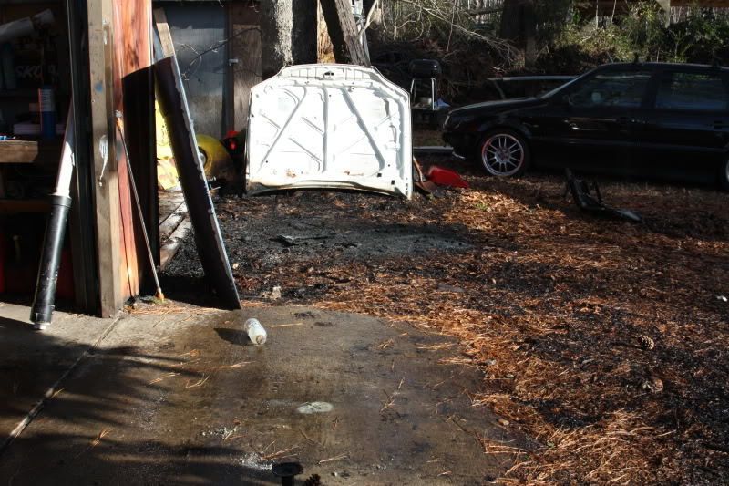

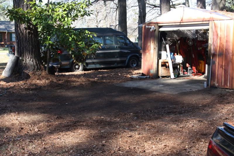

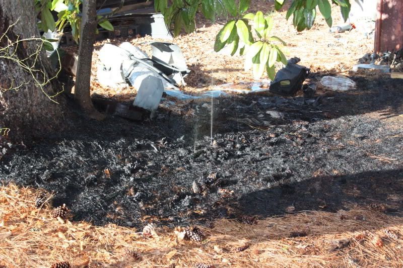

Out to in front of the building, now into brush and leaves in a wide-open area.

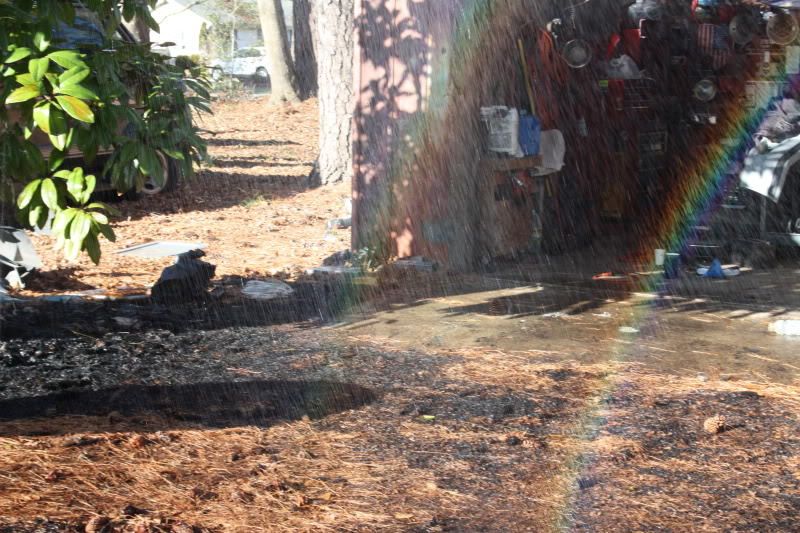

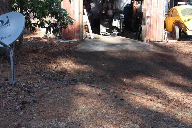

Onto the other side of the building entrance. Burned through a water line.

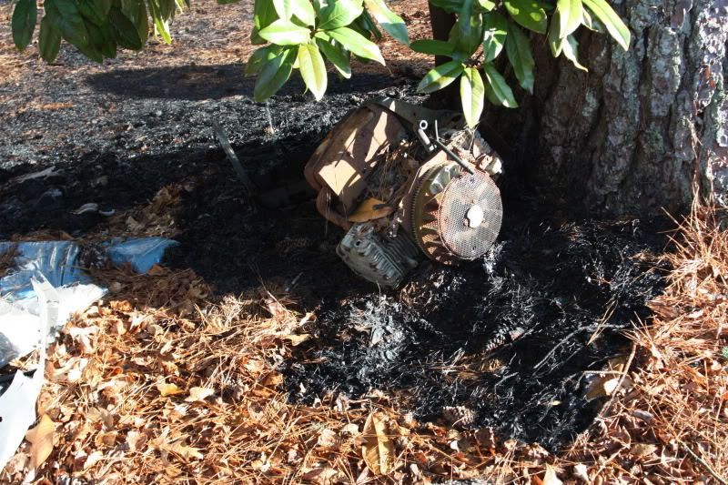

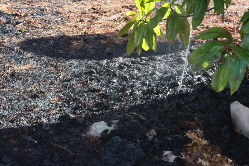

Around a tree.

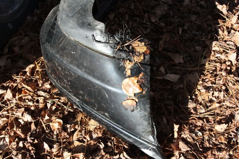

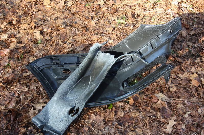

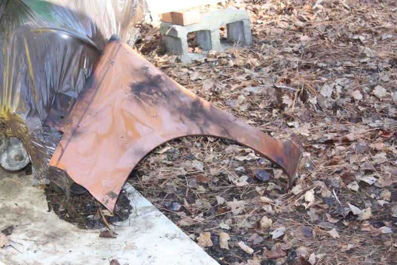

Burned up a rather rare, expensive and hard to find European OEM bumper cover.

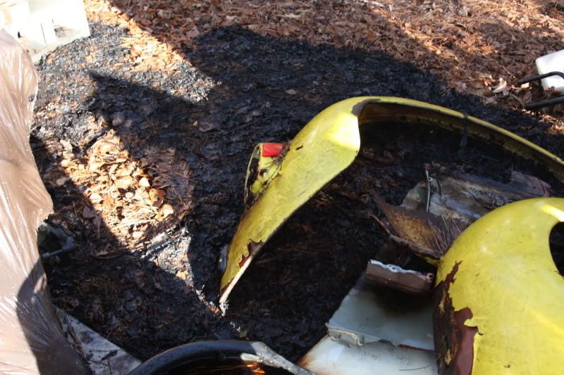

Some more parts

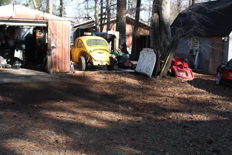

This all could have been MUCH worse. You can see in various photo's the fire was only a few inches or feet from a slew of various vehicles parked randomly in the yard. There are MANY more vehicles only about 5 yards from the area of the fire that are parked in the front yard. It could have EASILY blown out into the front yard and caught more vehicles on fire or even the home or other wooden buildings.
This all happened within 30 minutes. From no fire, no smoke...to coming outside to a yard full of smoke and creeping flames seemingly in every direction. I normally like to "play" with fire. Explosions and controlled fires are part of almost every weekend. This was the most uncontrolled fire we've had here. It luckily was under control within 90 seconds of noticing. A simple garden hose was able to go around and put out the outer edges of the brush fires. This was a fire that just crept along the ground fueled by leaves and some plastic parts. You notice that it burnt completely under and around the VW beetle only catching fire to some carpet inside through a hole in the floor pan. If left alone for another 30 seconds...It would have caught 2 vehicles on fire a large pine tree and 50 gallons of fuels and bottles of propane.
This is what it looked like a few hours later. All cleaned up like nothing happened. People can hardy tell!
All's normal and back to work just a few hours later!
