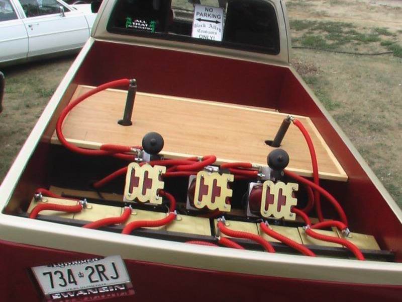

So i have been thinking of going hydros instead of air and found this truck for 4900 complete with hydros what you guys think.
I figure that this might be a good deal

That would be a good deal. Not sure how the suspension was done, might be a squeeky buckboard suspension be that is easily fixed. The CCE pumps are similar to what i was looking at for you. The 3 pumps setup usually has 1 front and 2 rear pumps so that you can do a power 3 wheel. Or have 2 pumps to the front for hoping and 1 to the rear just to raise it up. Looks like he is running a 48 volt setup. 1 group of 4 batteries to the front and 1 group of 4 batteries to the rear. Again, nice to have all the batteries for hoping ballast, but sucks to have to ask the 4 banger to pull around an extra 700 pounds worth of batteries.
