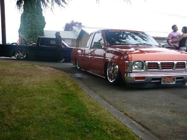

saw this today in town we dont have very man cool bagged trucks i saw this and stopped to take pics he is from somewhere in portland

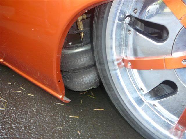

very clean that bag so close to the tire though would scare the hell out of me. but looks damn good
thats why i took the bag pic looked a lil odd to me

Sweet lookin hardbody! Gotta love that back bumper layin on the ground - very nice. Kinda reminds me of some other truck I have seen LOL. As for the rear bag I assume it.s bag on bar with the bottom bars mounted outside the frame instead of inside the frame.

nice truck looks good but ya that bag is not in a good location plus looks like it is off center to the bar which will cause him to go through bushings fast.

aired out and theres alot of bag to go still, most not get to high of lift

looks like the bars are under the frame on the sides with a plate that comes out but not a very well dezigned rear setup. Like mazdaman said he has like about another 3 to 4 inches of that bag left wich is rediculus if he is laid out
