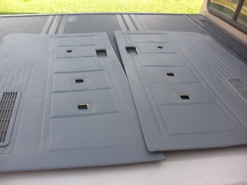

Welcome! Post pictures of out truck sad projects. We are all picture whores.

How can I tell what type of door panels I have? The front end is in good shape. I had the wheel alignment done and they looked for worn components. It's the steering box for sure.

Post a picture...
This is the standard panel.
mikedee
Not the ones I have. Mine curve at the top.
dan woodland's avatar
dan woodland
Yours are upgraded door covers... you may want to try finding a place to recover or make new ones. They are pretty hard to find in great shape.
