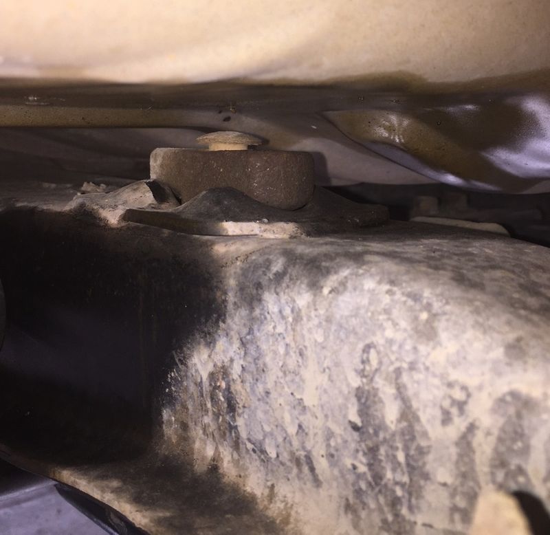

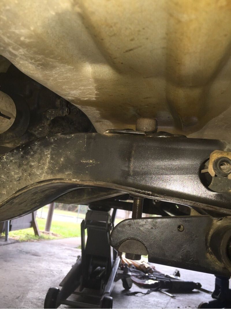

How about some pics?
mistah_tattoo
I'll take some now. I've got the tension off the T-bar now I'm just stuck getting the adjustment bolt out (wound out) so I can take the torsion bar out and reindex it.

I hope these help. It's probably quite simple what I'm doing wrong but I can't figure it out.
sincitylocal's avatar
sincitylocal
That little mushroom top is a rubber dust cover. The other one looks like it's missing. Either way, it looks like you're going about it the right way. It also looks like you've given them a good soaking in penetrating oil, so maybe you just need to let it sit for a while.
mistah_tattoo
Thanks for your help sincitylocal I ended up getting the drivers side off reindexed and back in and moved on to the passenger side. Cranked the adjustment bolt a couple of times and it snapped, nearly broke my hand when the torsion bar hit it. Lesson learnt! I should have dropped the balljoint lowering the LCA to relieve some tension. Anyone reading this, be careful guys. I escaped with a sore thumb, could have been a lot worse.
