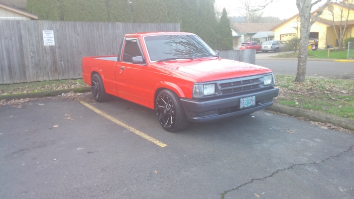

Hey guys I'm new here and only been messing with this truck I got for two years.my ? Is , what are my options to put a locker in my 89 Mazda b2200
mazdizzle
84-85 rx7 gsl lsd fits but you have to weld head bolts to the ends of the axles to lengthen them. I had one in my truck for a while.
