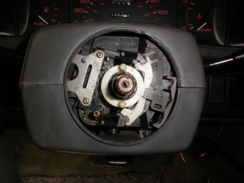

There should be a White circular collar under the steering wheel (inside the multi-switch) with two pins protruding out toward the driver. These pins are what "connects" the steering wheel with the cancelation mechanism. As the wheel turns it turns the collar. See below...
If that is intact then it may be the plastic cancel "arm" just to the right of the collar.

scotch
My money is on the little arm to the right. There is a spring that puts a lot of tension on it and every one I've found that doesn't work was due to that piece being cracked in the center.
I have yet to figure out how get this assembly apart without breaking it. Your best bet will probably be replacing the whole assembly. See ABE's thread below to see which style you will need (4 terminal connector or 5) and also how to clean up all the points inside. Might as well clean everything up before you install a replacement assembly.
