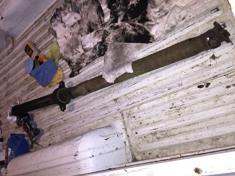

My carrier bearing is blown out and i was wondering how to get this thing off?! Do i have to press it?

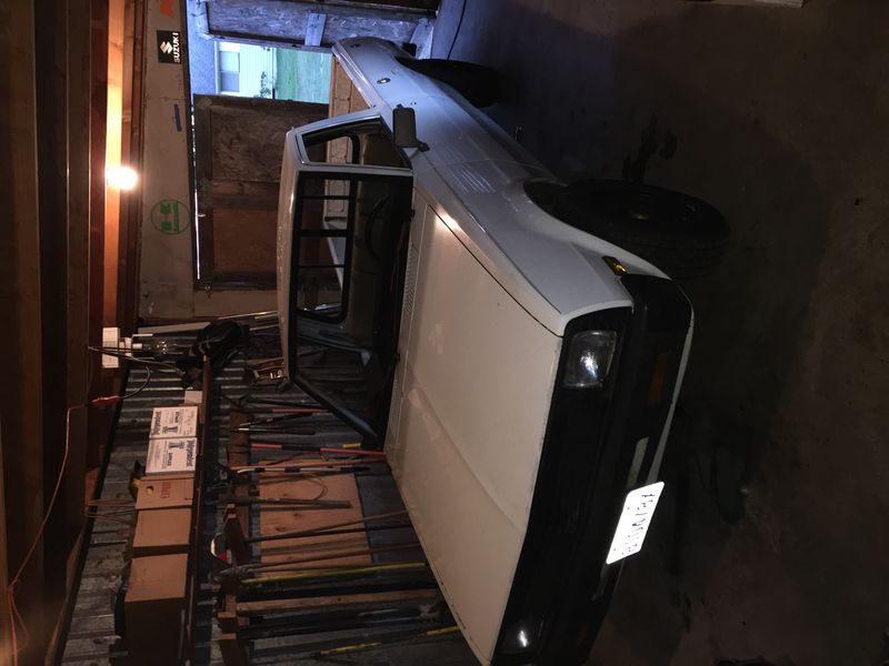

This ones just for fun cause i know everyone likes pics. Its a pretty nice truck. Really strait! 124,xxx miles. Picked it up for $900 and it just needed a clutch. Im gonna use it as a daily driver while i rotary swap my b2200

You have to remove the nut that holds the yoke(nearest to the bearing) on the shaft.
On a B it can be done with a wrench, but it's so much easier if you breakdown the u-joint and remove the nut with a socket.

Ok so im gonna have to pull the joint apart and get it pressed off?
sincitylocal's avatar
sincitylocal
It should be splined. It isn't pressed on, but rust might have a good grip on it.
Pull the nut, and if you can't just pull it apart, spray some good penetrating oil in there.
After letting it sit for a bit, whack it with a dead blow hammer.

So i took your advice sin city and it works thanks!
