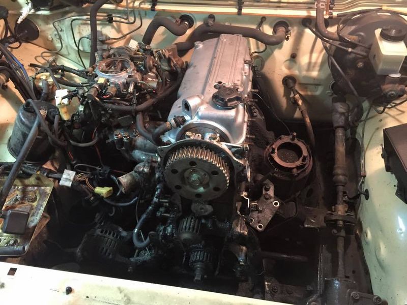

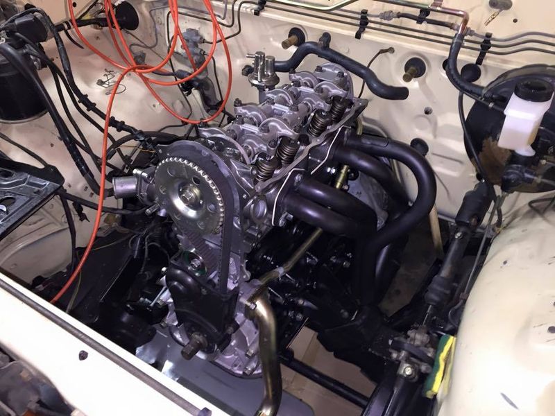

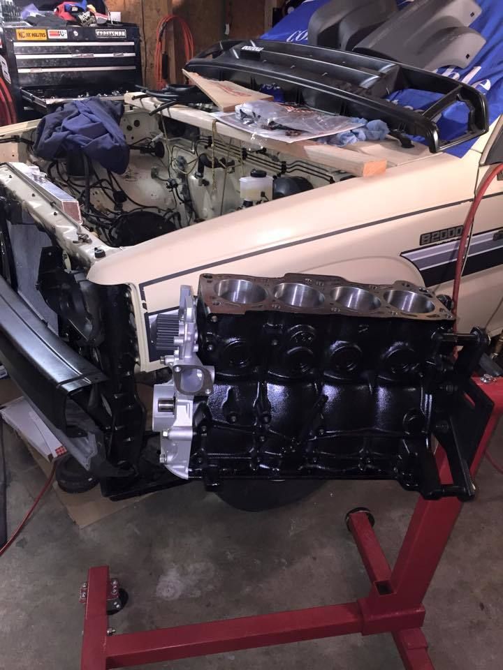

Just thought I would throw a few pics of the rebuild.

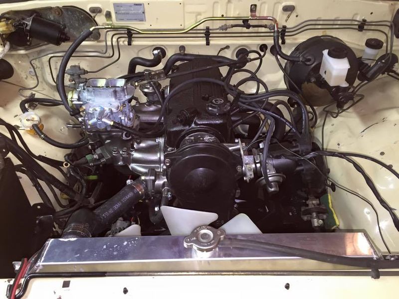

Almost finished. Runs great, just working out the little bugs...
axel breaker earl's avatar
axel breaker earl
Looks very nice in there! Congrats on the build!
