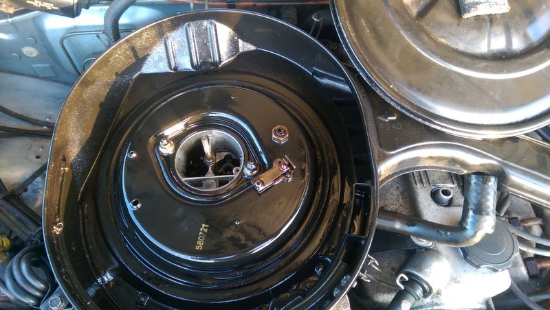

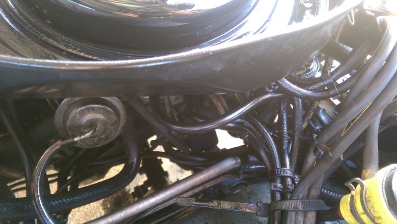

bustedknuckles_420
Not sure what's going on my valve guides are bad I'm sure then if it goes over 70mph we will over heat. My question earlier noticed a tick loud noticed oil was low. Added oil drove a lil tick went away.
So drove it home on the hwy never smokes bad on the hwy, on a uphill it bogs starts to smoke for 20 sec or so then my alternator belt brakes. Then the smoke goes away. Another ten min of driving. I get home and oil is all over the passenger side frame dripping out the air box.
What the hell

If she smokes at start up then goes away at operating temp it's the rings...
See if your PCV valve is operating correctly. If it doesn't rattle when shaken try some carb cleaner and reinstall. If it still doesn't work I suggest getting new from the dealer (from experience we here know the OEM models are good).
geterdun's avatar
geterdun
Cold engine start up smokes, but stops quickly, more like the valve seals.
