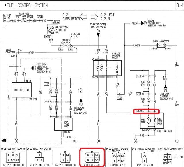

While replacing the fuel pump, I accidentally pull the 5 wires from the wire harness from the fuel tank to the harness on the frame. There is a six pin connector, but only five wires. One connector slot is blocked off. If you have a pic or know the wiring pin out, please help. There is at least one solid red wire of the five.
