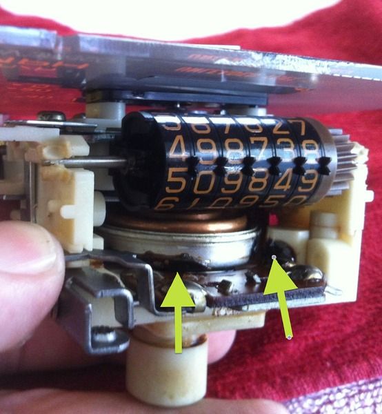

1. Was the speedometer cable all gooked up with oil...turned to grease? Grease on the back of the speedo cluster that got pushed out the cable? If so, then you need to clean the grease from the speedo head. Was this truck sitting for a while before you got it? Here is a picture of a speedo assembly that had gear oil pushed up the speed cable and got inside the speedometer.
Cleaning it from the fitting where the cable attaches won't solve the problem because it's the inside that is gummed up.

1. When I took the cable off of the back of the speedometer it was full of grease. I will disassemble and clean it. Nice pic.

When you take the cluster apart, the black trim comes off WITH the clear plastic lens. Don't try to separate the clear lens by itself, else you'll crack it. You'll probably see some grease inside that copper area too. I used some electrical contact cleaner and that small straw to blow and wash it out.

1. Speedometer. Took it apart and found that it was full of grease in the back. Using a GPS I am now within 3 to 5 miles accuracy.

1. Speedometer. It started acting up again. I took it apart cleaned it again. Now i am within 4 miles.
