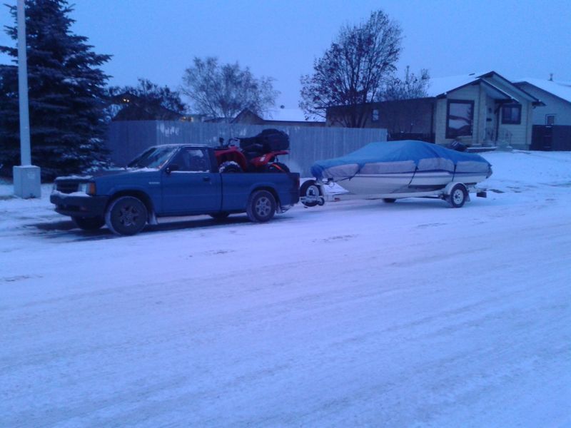

It wont be fast, but the rear bumper is rated for 2000lbs max. I pulled a 2600lb boat 10KM across the city I live in during a snow storm (with an ATV in the box). I was not fast by any means with the torqueless rotary motor, involved a bunch of clutch slipping to get going, and coming to a traffic light slowly hoping it would change. The biggest problem may be highway speeds, if it is a manual, you may have to tow in 4th gear.

Proof: Although I didn't get above 30MPH, I out dragged a minivan from some traffic lights, lol, she got me off the line, but by the other side of the intersection, I was ahead by a car length.
