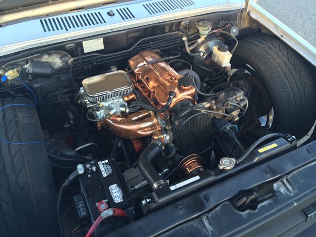

Hi guys I'm new to the site. I have a 86 b2000 ex cab that's bagged and body dropped on 20's. My question is has anyone relocated the clutch reservoir and if so to where? My tire hits it when laid out.

you can relocate it anywhere you can thread bolts in to. on my evo i cut the actual tray of the glove box out and ran my master cylinders and standalone ecu in it and bolted them to the firewall. you cant tell its modified when its closed and yeah, now the box is useless but its a dedicated track car so it really doesnt matter.

Just the resevoir or the whole master cylinder? Our MC was flipped around and mounted under the dash. Just made a simple linkage setup and ran a new hydraulic line into it.

I dig the copper plated parts!

Sorry need the master cylinder relocated as well.
