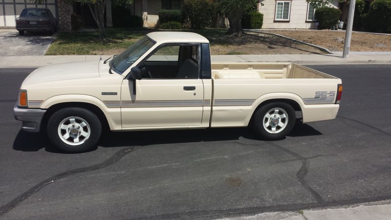

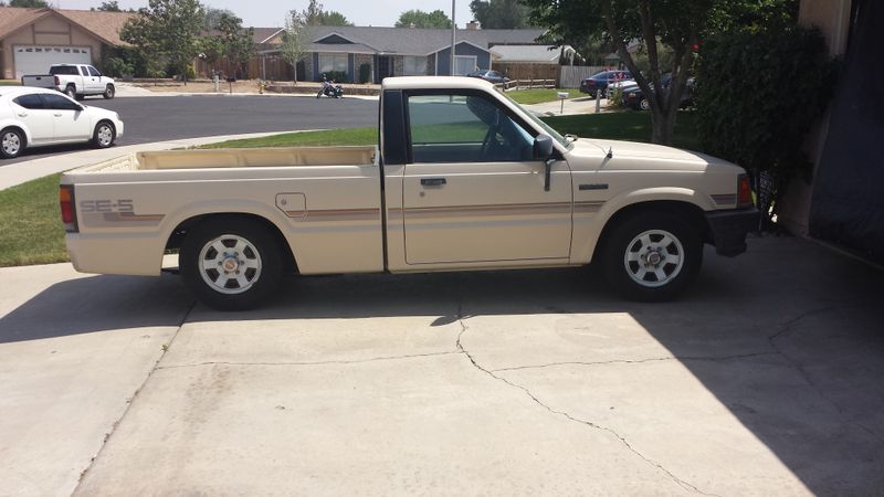

Hello everyone,im new to these trucks and im wanting to lower my 87 b2000. It has stock tires and rims. Looks like the front is about 3-4 inches above the tire and the rear is about 9 inches above the top of tire! Looks too high for my taste. I have been reading about 3 inch blocks but im thinking it need alot more than 3 inches in the rear? thx Its not a DD

Only thing is 3 in in the back won't even lower it much?
anguswilly
Not only will 3" not lower it much, you'll be illegal in some states depending on your wheel size and it can give you axle wrap.
I am currently at a 5.5 drop with a 4" de-arch and 1.5" block. I should have done an inch or 2 more de-arch but did not want to c-notch it right away, I will most likely notch it and then get the springs de-arched more.

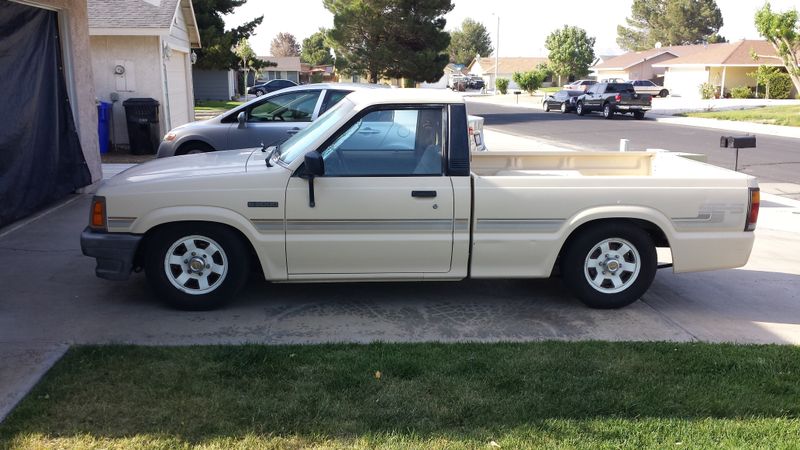

gwjvw
" target="_blank
gwjvw
Looks like a 4x4 lol

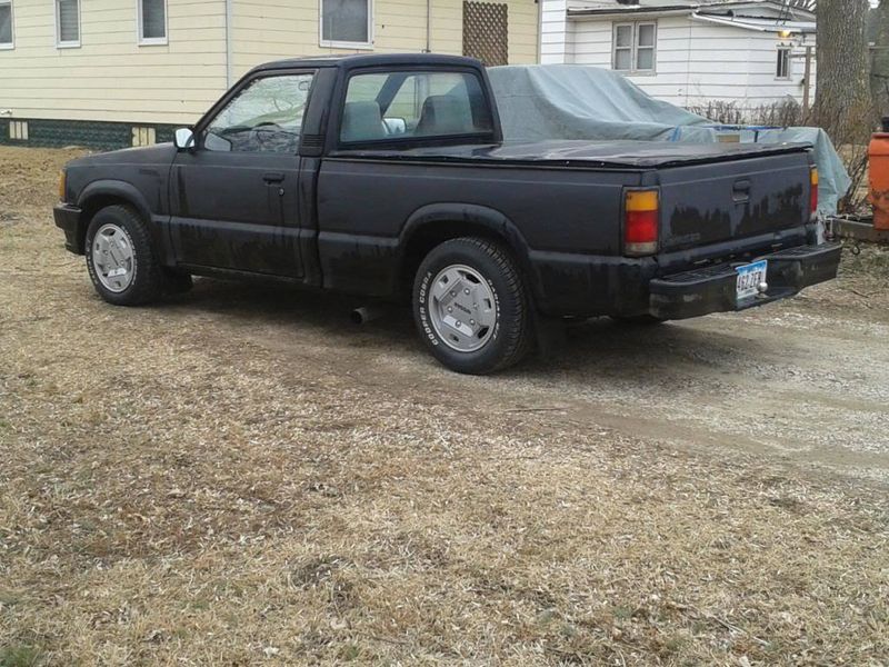

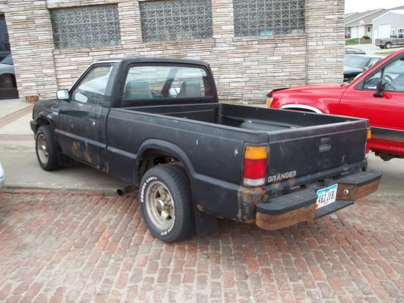

looks as if someone already played with the torsions up front.

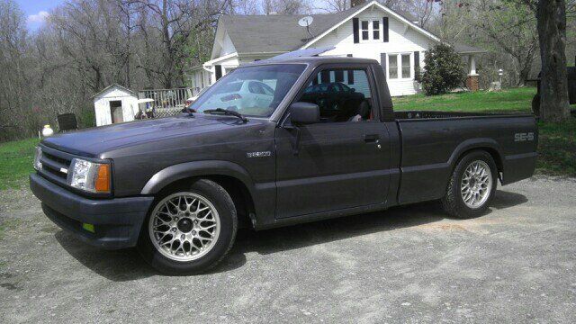

When I got mine it sat a little more level then that. I lowered mine 2 inches all around. I have a 3.5 inch fender to tire gap.

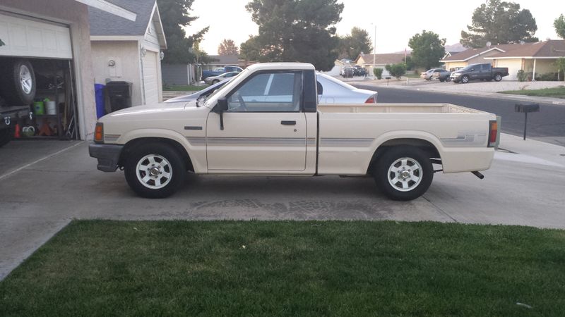

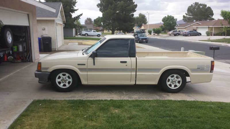

Here it is before I lowered it and painted it. you can see a difference with just 2 inch blocks.
My next truck is getting 4 inch blocks.

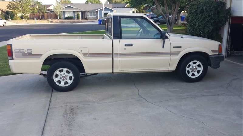

same tires different wheels.

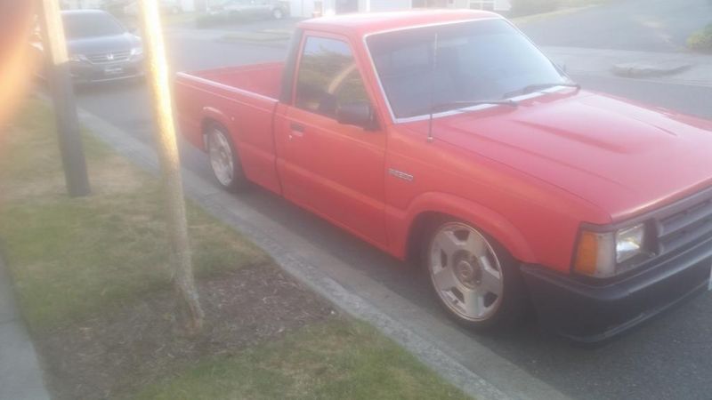

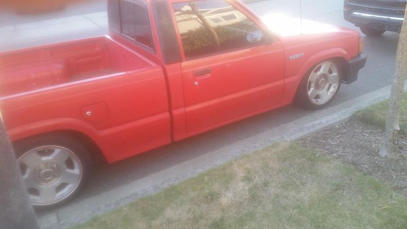

I just took out the 2 middle leafs and it lowered it about 4 inches
