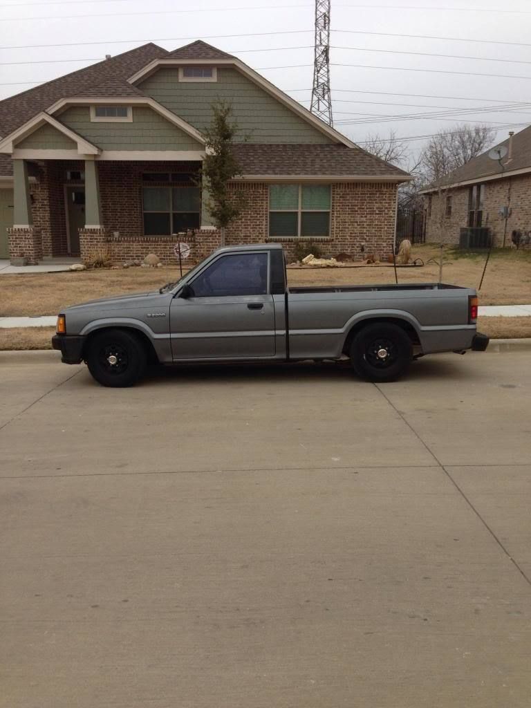

Hey guys I'm new to the forum, I have a 1991 b2200 single cab lowered on 3" blocks and 3" drop spindles that's about to have 18" Titan wheels

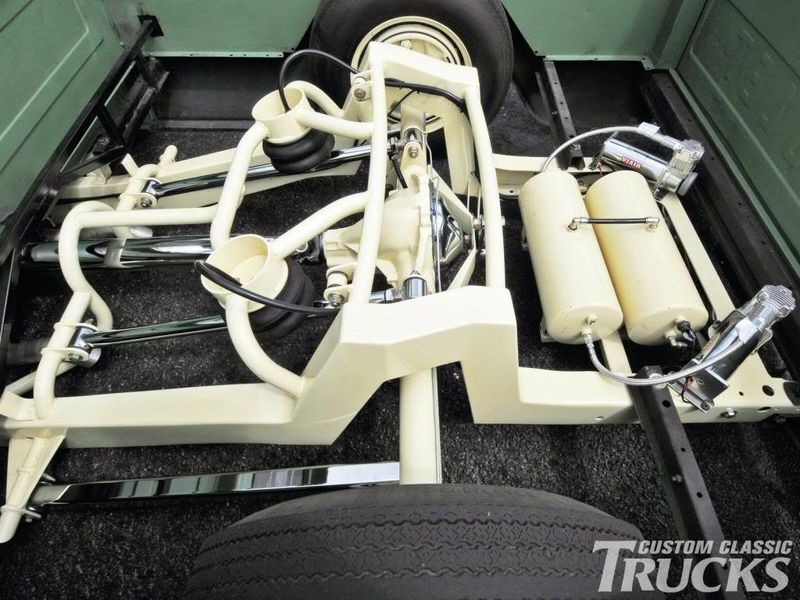

1. Is there any way my truck can be bagged and not cut a big hole in the bed (I want the bed to be as close to stock as possible)

I suggest raising the bed floor and doing a small notch. Nice lookin truck!

Oh I'm going to try to leave the cab as untouched as I can and is want the bed floor to be as close to stock as possible as I will be hauling things. Thanks for your help man! Would it be possible to have the tank and compressor hidden somewhere?

Yes. U can hide the tank and compressor under the bed floor. Just google raised bed floors and get some ideas. U can even keep your inner fenders
