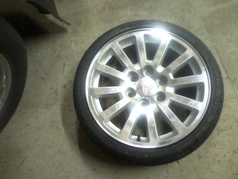

One of these days soon I'm grinding the tabs on my truck for the 18" GMC wheels I have...just need to find the time to do it.
