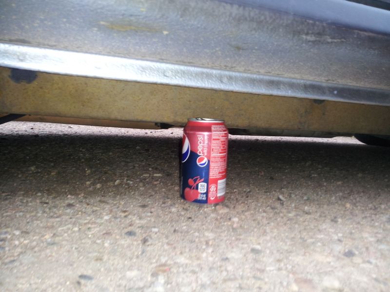

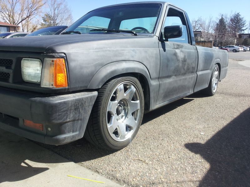

I'm reindexed 3 or 4 splines with the torsion bolts about half way. And mono leafed plus 4 inch blocks. It rides rough over large bumps but it's not too bad for most driving.
my frame is less than the height of a pop can from the ground. And keep in mind that's with 17s with 45 series tires
