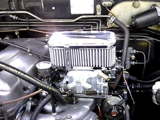

Starting in 1986, Mazda used PTC - the fancy name for a "carb heat plate" to prevent carb icing in winter . The temp switch is supposed to turn it on when coolant temp is below 41 degrees.

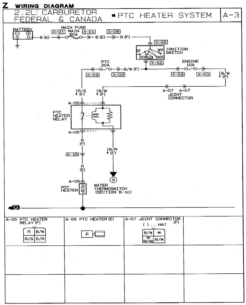

When I installed a Weber kit on my 1989 pickup (two days ago) I retained this carb heat plate, making a small mod to the adapter plate gasket so the heater will make contact. Been to busy tuning a Weber and eliminating wires and hoses, have not traced the heat plate wire. I assume it goes straight to a coolant temp switch, but it may go through a relay because of higher current draw.
Anybody knowing about this could give me a heads up.
I retained the PTC system because of a lesson I learned with Offy intake on a Ford 300 six. Cold winter nights my carb would ice up and the old Ford would hardly run.

Nope!
The PTC has a relay. It operates completely independent of the ECU, and the thermoswitch is located in the bottom radiator tank.

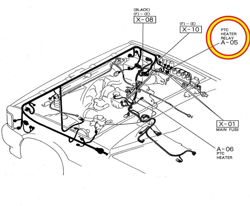

is that image reversed?

Nope. The relay will be on the right side inner fender, if so equipped.

Thanks guys, for the PTC input! The diagram is very helpful. Hey, I've noticed there's some pretty smart people out there! (besides me of course, ha ha)
