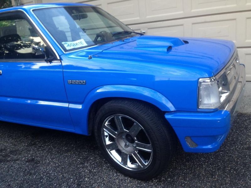

Hey everyone,
I need to get a tire that will not expand further than my rim.
Right now it rubs like crazy and they wont tuck up in the fenders. What I have is an 2010 Escalade 18"x 8" currently sitting on P245/50R18.
Please help me figure this out. thanks in advance
