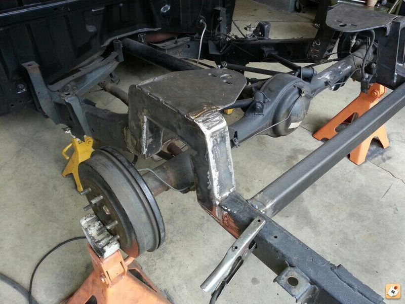

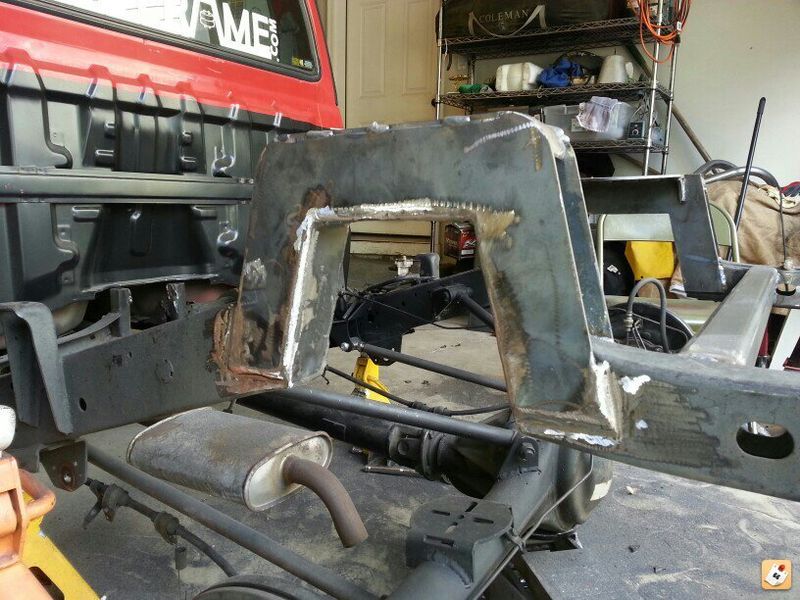

I just did my c notch and have a couple pointers. Make sure you account for axle arch when placing your notch. Meaning the lower you go, the further forward your axle moves do to the drive line. I measured mine from where my ride height would be and at full compression down, the axle sat about an inch forward from original measurement. Also, in would recommend doing one piece side plates so you can weld it to the side of the frame. More strength and weldable surface area.
