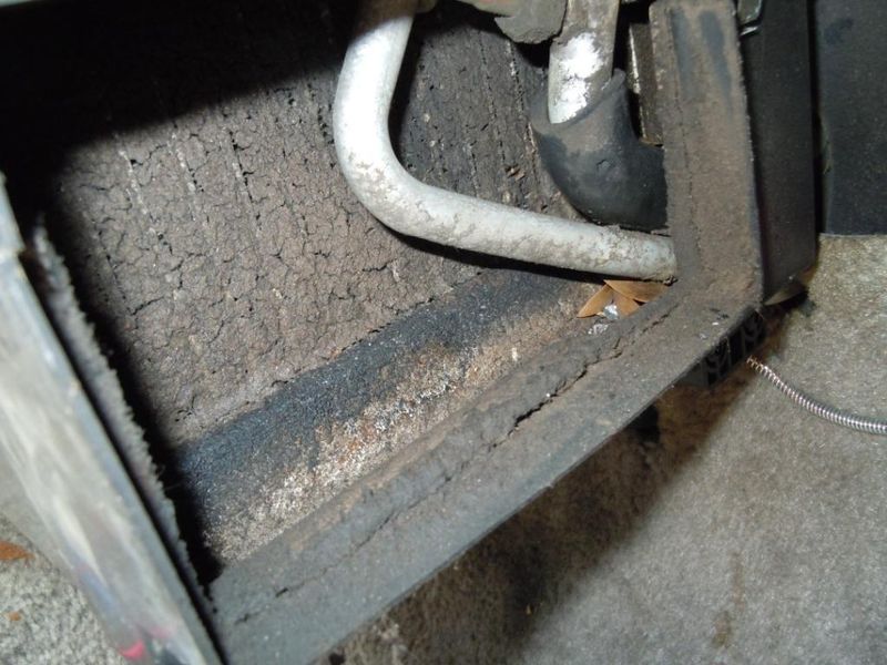

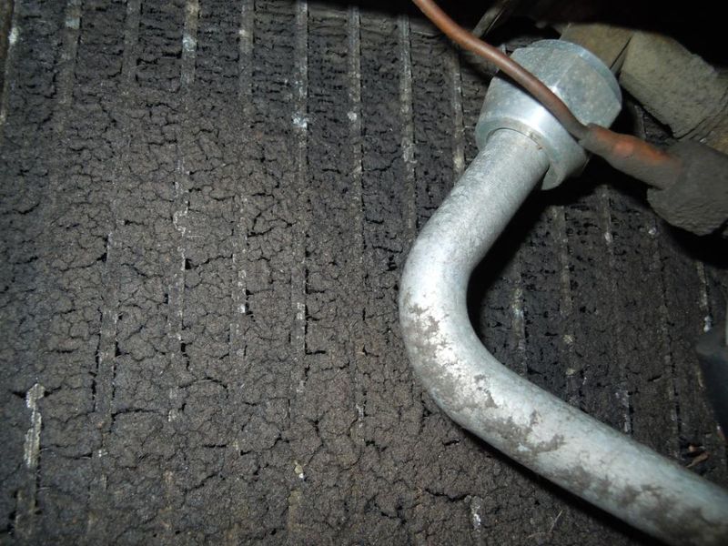

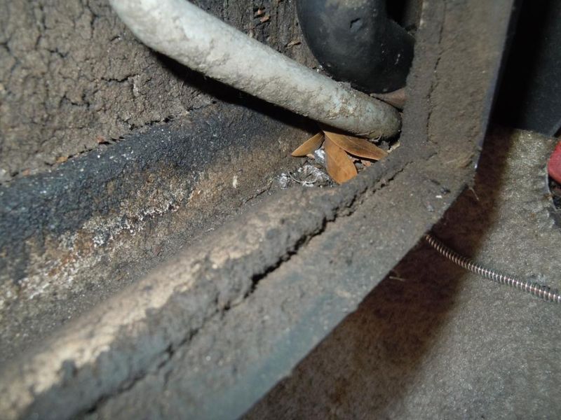

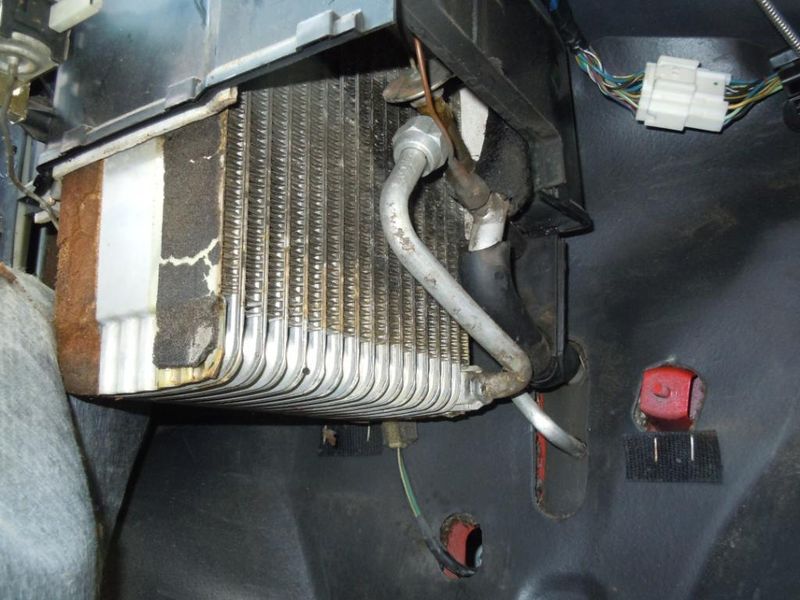

There is a cycling switch that's mounted on the outside of the evap. core housing......maybe it is working intermittently and you just hit the right time it decided to work........BUT, if your evap. core is matted up with dust & hair (from pets that used to ride along?) and your not getting good airflow across the core, it could freeze up and the cycling switch will shut the compressor off........of course once the A/C hasn't been on for some time, it will turn itself back on since the core has warmed up or de-iced.
One of the things I do when I get a Mazda truck for the first time, and it has A/C, is clean the evaporator core and replace all of the seals on everything down there.......here's what a dirty core looks like!
I've had them dirtier than this also!
After pulling the lower half of the housing off and cleaning it........flows way more air through the vents as well!
