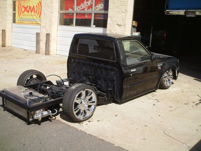

16 gallon fuel cell with aftermarket gauge

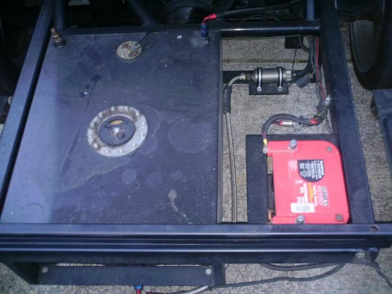

16 gallon from summit with an aftermarket gauge as well
