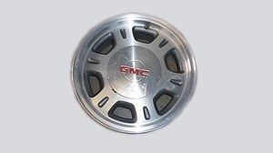

Will these yukon wheels fit on my mazda 2200. There 15x7 I think
h2omelon(nick)'s avatar
h2omelon(nick)
If they are 6 lug yes. The tabs will have to be ground or centers of wheels have to have the bore opened up.

Thanks for the help fellas.
Yeah they will fit but like mentioned they will have to be bored.

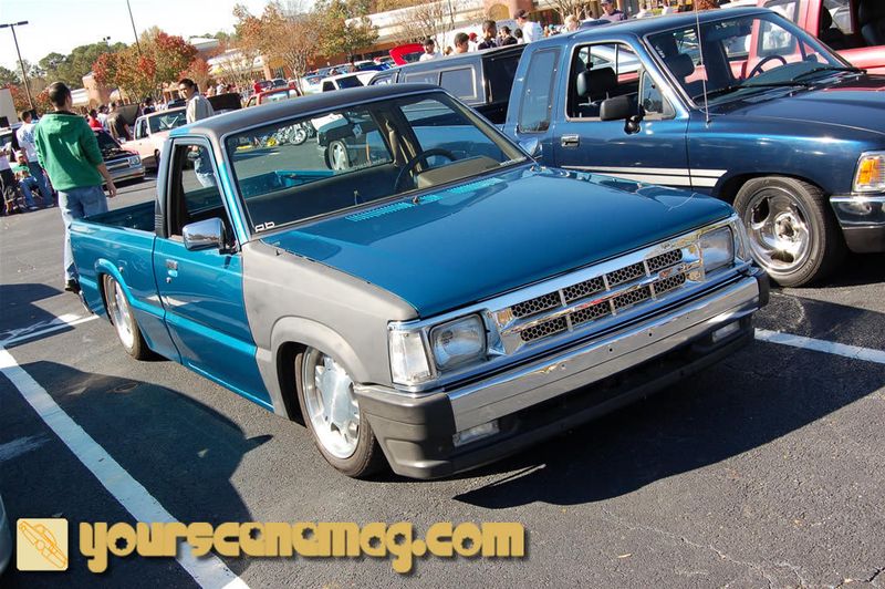

Mark's Mazda with them.
