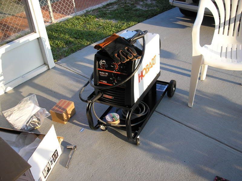

please dont buy a crappy harbor junk welder save and buy a decent welder u pretty much will hold on to it forever u can get a hobart/miller or lincoln for a good price just look around i dont know if u have a tractor supply store around your area but i bought my first welder hobart handler 180 its 220v mig or flux core came with a cart regulator and gloves and is capable of runnin the 10lb spools hobart has same internals as miller just hobart the whip is actually a miller paid 650 for it had it about 6yrs great welder does the thin stuff and has the amps to do the larger stuff
