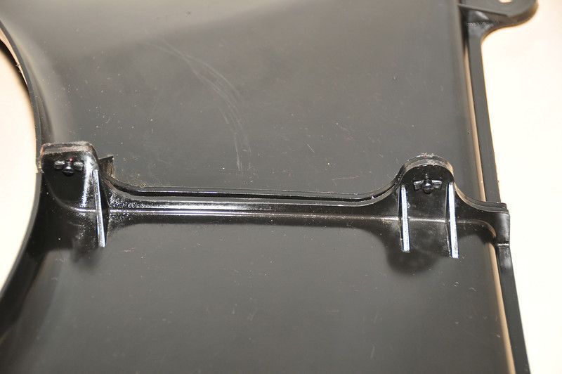

Here is a quick peek at the bottom side of the rivets...
ram23
Yes like 91_2600i said you will have to cut them, that is what the original owner of my truck had to do too. Its now held on with zip ties
billfish0456
Thanks for the great pic - where did you get it? yup, that's them. guess i'll have to try to get the fan off before pulling the whole shroud, or cut them as 'ram23' confirms. dealership says they are still available cheap enough, but will take a while to get in.
