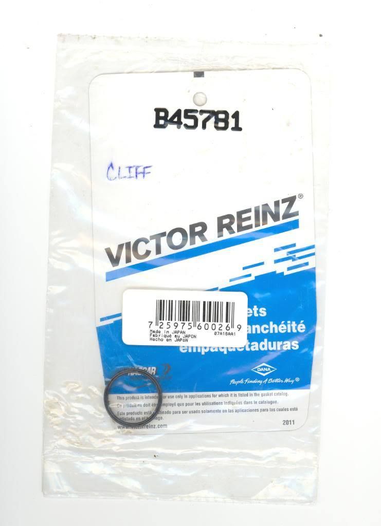

Here is the Victor Reinz part number for the O-ring on the distributor housing.

Who's Victor Reinz?
I still have the new distributor O-ring from the FelPro kit from my rebuild, didn't replace it then.
