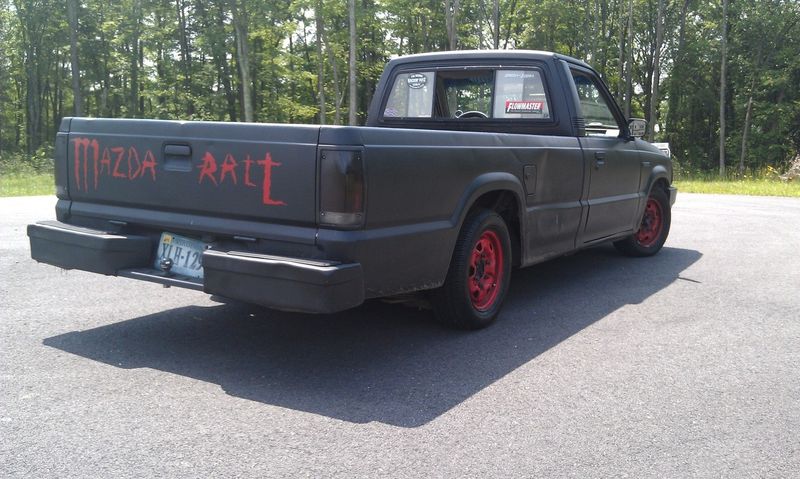

Well I got bad news about my little rat rod Mazda, I had replaced my master and slave cylinders for the clutch, bled everything like i was suppose to and now i still have no clutch, I'm hoping that its not anything internal in the transmission.
