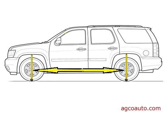

i got an mazda b2200 and i need to kno how to make sure my rear end is straight an easy tips or any advice would be great thanks
oo7bob's avatar
oo7bob
tape measure, from center of front wheel to center of rear wheel. both sides should be exactly the same.
sincitylocal's avatar
sincitylocal
OO7bob is right, but to be accurate, you need to measure diagonally too.
Left rear to right front, and right rear to left front.
I believe factory specs allow for plus or minus 1/8 inch difference between left and right side measurements, and plus or minus 1/8 inch between diagonal measurements.

it doesn't matter, as long as the measurements are the same left to right and diagonal.
bigdaddy6
Its your thrust angle, should be center, if you have a 4-link rear suspension then it will be easily adjustable, if not you'll have to unbolt some stuff and get it straight then retighten...
