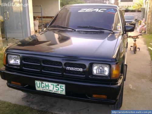

I saw a B2200 with all-orange front running light lenses and it looked good. This is the upper wrap around "running light" lenses (NOT the lower rectangular turn signal lenses). I saw them on this truck (see pic, might be an overseas or South American spec truck due to front plate) and also on a US truck on this forum but can't find it now. After checking aftermarket replacements online, all I can find are the OEM replacement lenses with orange on the side and frosted white on the front. Or, an all-white (frosted) lens.
Just wondering if there's any place that sells the all-orange lenses? Or do I just buy some orange vinyl and "tint" my stock lights or buy some aftermarket all-white lights and tint them orange? The gaskets for my stock lenses are really disintegrating, so new gaskets would be nice too.

I think they are aftermarket, but not 100% sure they didn't come that way in another market somewhere. Try searching Ebay.

They are OEM, but not for the North American market.

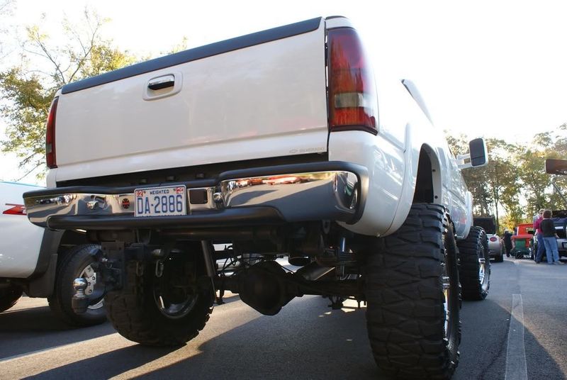

Another option, if getting those lenses shipped over here is cost prohibitive, you could tint them amber yourself. You would do the same process I used to "candy" my tail lights to get RID of the amber portion. Using transparent paint, followed by regular automotive clear.

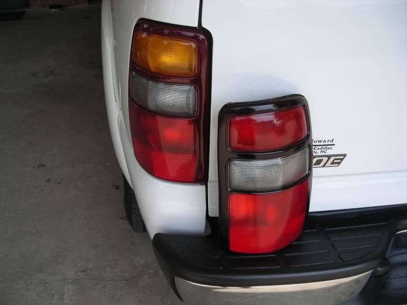

Here I used Testors model paint, transparent candy red, followed by automotive clear.
A set I did, before buffing
The ones on my truck, buffed.

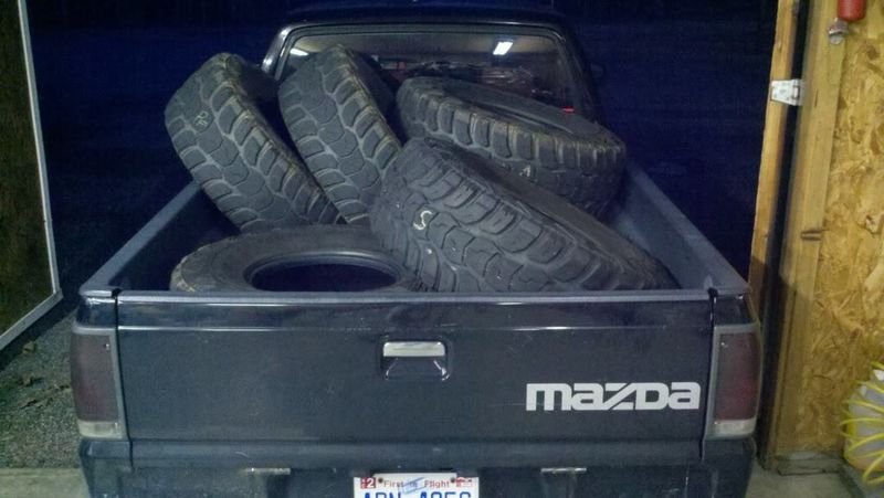

The ones I did on my B, except these I added some black/clear mix to smoke them, and didn't bury them in clear or buff, I kinda liked the satin look.

That looks good! I like how the Tahoe tail lights turned out. I'm a bit nervous to paint the lights, but there's an orange vinyl tint available too. I believe it's specifically for tinting tail lights, fog lights, etc. So I could order that and cover my stock lenses. Or get a set of clear/frosted aftermarket lenses and tint those so there wouldn't be any difference in the shade of orange (since part of the lens is white and part of it is already orange).
