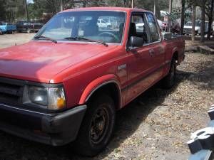

yall are awesome my buddie got this truck in today and pics look great going to junkyard tomorrow to check it out fully loaded all original he says said it only has a blown headgasket might try to talk him out of whole truck if price is right

hey here is the Picture he sent me incase yall want to see it

get the bumper trim....get as much trim as you can...
