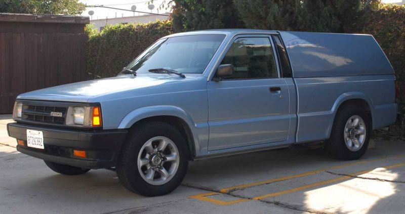

I think I found this picture here at MazdaBscene but I don't remember... Anyone know what these wheels are from, or if they're aftermarket? They have the new style Mazda logo on the center cap, but that could have been added afterwards, so no guarantee they're Mazda wheels. They look like they might be some OEM wheels, just wondering what they're from. And if that's your truck, it looks kick @$$! Love that look! Clean and subtle.
Those wheels look awesome on this truck! Maybe it's the height the truck sits at, maybe it's the light blue color paint with those silver wheels, maybe it's the windowless canopy/cap. Or a combination of all those things.

Those are early '90s Mitsubishi Montero rims, on aluminum hub center rings. 215/65/15 Yokohama Avid tires. OE Mazda hubcaps, with modern Mazda logos added, from an eBay vendor in Bulgaria.
The offset isn't quit right. I doubt they'd tuck on 2WD sheet metal. With my 2" drop, I've had no issues.
See my garage for more info.

Awesome! Glad I found the owner of this truck! Those wheels really set off your truck nicely. Almost makes me want to lower my truck 2" instead of lifting it 2" and going with taller tires. Then again, that might look good too, with those rims. Those rims are the style I had in mind, just didn't come across any. I'll have to check eBay or Craigslist for a set and then sell my Nissan rims.
I'm not sure what you meant regarding the offset... did you think I would, or would not have any trouble clearing the stock 2WD sheet metal? Currently I'm at stock height, but I could lower or lift the truck a couple of inches. I was planning to lift it. Might not look that bad with Montero rims and maybe 235/75R15 or even 215/70R15 tires.
Looks pretty slick with the 215/65R15 tires and the 2" drop you did. Right height and tire size to pull off the look. And how did it change the ride and handling of your truck?

If you lower no more than two inches, and don't carry more than 600 pounds, you won't have any trouble. Well, I do get mud spray on my bodywork. I may add some tiny mudflaps.

In fact, the offset may be fine. My tires are 10mm oversize. I like 215/65/15 because the tread diameter is identical to stock 205/75/14, so no gearing change, or speedo/odo error.

Ride/handling: handles far better. Ride is firm, not harsh. I hit the (unmodified) bump-stops often enough to keep the adjacent metal clean.

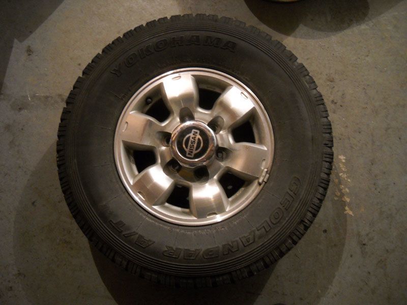

But, my aluminum 15x7 Nissan wheels (from a 1997 Pathfinder) look similar to those Mitsubishi Montero wheels - see pic below. I discovered that if I leave off the stock (and very chunky looking) Nissan center cap and use the stock Mazda center cap, those wheels look pretty good. The Mazda center cap will need to be modified to fit properly though.
My Nissan wheels are absolutely mint. But I'd love to paint them graphite or gunmetal gray. It pains me to sand and paint a set of wheels (with a rattle can) that have an immaculate factory finish. Are your rims painted (either by you or from the factory)? They look slightly darker than plain aluminum and I like it.
As for shocks, I should probably upgrade mine and install some kind of load helper kit to prevent the back end from sagging or bottoming out when the truck is loaded with cargo. Now I'm undecided if I want to lift the truck 2" and use big meaty tires 235/75R15 tires, or lower it 2" and use 215/65R15 tires. (I used a tire calculator and you're right, that size you are using is virtually identical in height/circumference to the stock tire size).Either way, I could still use my Nissan rims, or a set of Montero rims if I can get some.

Are your Montero wheels painted a slightly darker shade of gray? If so, did you do it or is that the way they came when new? Or maybe it's just the lighting in your pictures. Either way, they look good in that shade of gray.

OE Mitsu. paint as far as I know. Sun lit from behind, with fill flash.
